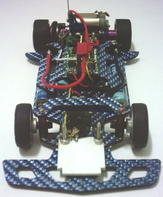

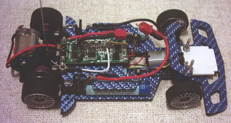

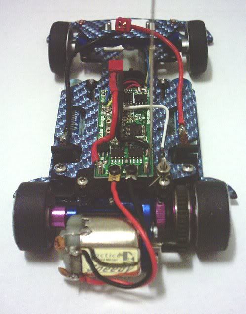

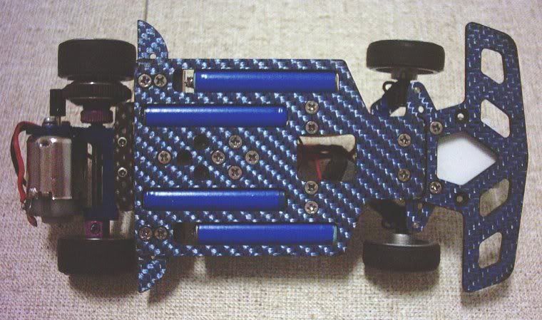

Hey PeteWah here’s thespecs of my Pro-Z
* It’s a Pro-ZV5 Team car in Blue carbon fiber with nerf barsand front bumper.
* PN Racing motor mount.
* PN Speedy practice modified motor with 8t pinion.
* Adjustable ball Diff.
*Full ball bearings.
* 0deg camber, 2deg toe-in,3deg Castor.
* Long rear diamond bar with center shock.
* Rear side shocks (only fits with PN motor mount).
* 750mAh AAA’s.
* Iwaver 02 main board with MR01 servo setup.
And heres some links to some pix.. As you can seeI’ve removed the servo case
at the moment asI was using an iwaver one but dont like it so im looking for a true
Kyosho one… I decided to remove it cause if I don’t, I’ll never get around to it !!!
Also the pix arn’t that good as my camera is on it’s way out !!! I think the kids got to it !!!
http://i23.photobucket.com/albums/b362/RCS2DIE4/My%20Pro-Z/Front.jpg
http://i23.photobucket.com/albums/b362/RCS2DIE4/My%20Pro-Z/Top.jpg
http://i23.photobucket.com/albums/b362/RCS2DIE4/My%20Pro-Z/Bottom.jpg
http://i23.photobucket.com/albums/b362/RCS2DIE4/My%20Pro-Z/Rear.jpg
