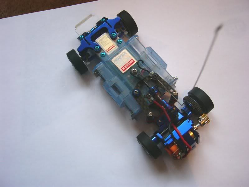

Next is My Kyosho MR01 That I built from hopups. It’s aBlue Nissan Skyline GTR R34and there is no point in listing the hopups as I would have to list every part of the car as I built it completely from hopups, It didn’t start as an RTR !!! One thing you cant see is a 5×2 Fet stack and the motor is a Kyosho Xspeed rotor (50turn)and magnets in a Yeah racing BB motor can with high carbon brushes running a 14t pinion.I get 50k’s onthe Speed Checker With fresh 800mAh Ni-MH batteries then 48k’s after about 10sec of full throttle it stays there till the batteries die off.. It’s a mad Z to run and it handles awesome !!!! I also have a Mini Z Workshop motor for this it’s a 35turn rotor, high carbon brushes, Yeah Racing bb Motor can andGold Neo Magnets… Haven’tspeed checked this yet but it’s crazzy fast !!!
