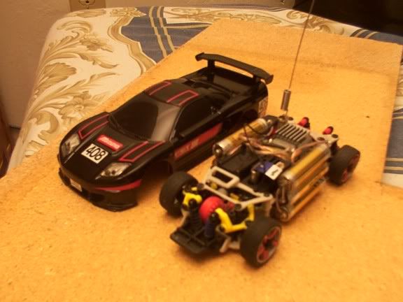

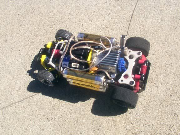

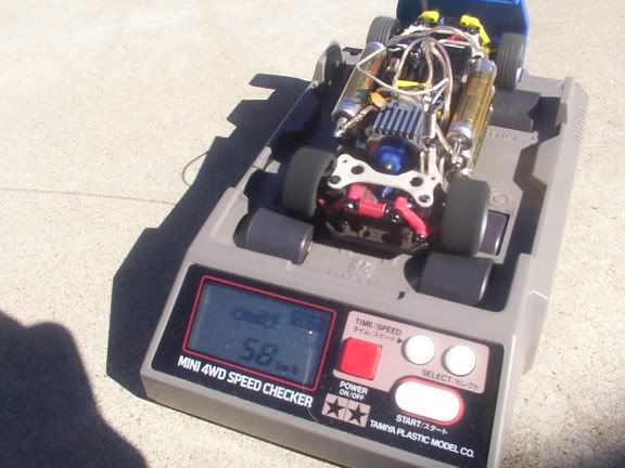

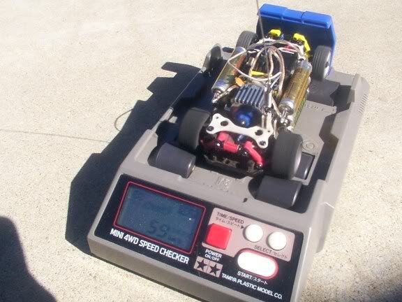

its still using the stock stage2 armature but with neos.
tha fets were jus change since i ran out. jus a single stack of SI s
so the car is pretty cheap and easy to build all together.
hrdest part is prolly the bevel pinioni took the pic before the flag came up to show thas wut the car wus currently running. 59kph came up rite after i took the pic. i usually get i the mid to high 60s but these batteries are a few years old and prolly gettin near its 1000th charge if not past it. i got them when the first 650mah cells came out. i jus didnt wannah use my new energizers750s to do this

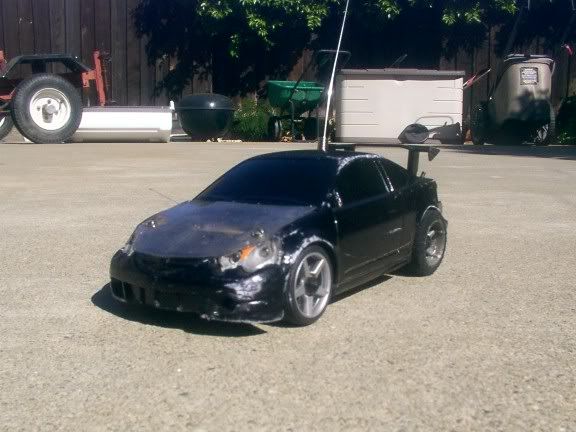

note that thats just a beater body and very temparary and jus for racing. im currently working on a skyline body for this car.
yes, i can rewind or mount a faster motor and stack fets, but i like the off the line missle like acceleration(thnx awd) and endurance it has on the track. i do wannah try a nelly and a plasma armature and see wut it gets on the checker

what have you done to the bevel pinion, how many turns does it equate to now??
love the rear fatties, they from the camaro or mustang????
October 12, 2004 at 12:57 am #56059
i guess its a 1:1 ratio from wut sumone else has told me(im not to at the technical lingo) i use 2 bevel gear and one of them for a pinion. i cut the hole bigger and squeezed in a small brass pinion with a vise then glued it in place.
my rear tire are wide tamyia foams for mini 4wd cars. to mke wider rim to fit the wide foams i customed 2 stock rsx rims. i cut and extra set i had in half and glued the back half in front of the rsx rims shaved down the spine in the rim, then i wus able to fit my fatty foams. dubblesided tape is needed cus they tend to fly off w/o them. i ight need sum newones soon, as u can see, their pretty eatin up from racing.
idea: this chassie has holes to mount a miniZ01 rear end. before i got a 55kph with 4cell and a stock motor with a mrs4 13tooth pinion. i jus got a 17tooth pinion i wannah see wut it can do with a six cell.

betty, haha ur pretty rite tha car rarely flips over. that body wus recently mounted on that car. it used to be on my 4cell car wich has been through alot since it wus my first xmod. thas my beater body, most of tha damage came from rough play with micros. also i abuse tha car very badly, ram and hit other cars, jump ramps , speed bumps, stairs, escalators, and has been ran over once. it ok thoe i got so many other bodies. and 3 of them are RSXs red, painted blk and the blk RSX top kit.

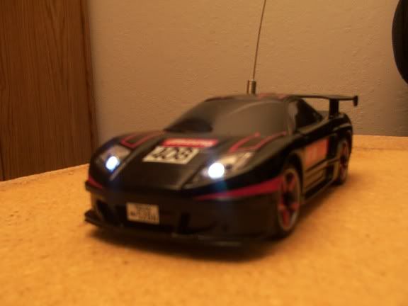

i finally got started on my skylines body work, current ly under blk primer still thinking of a color
heres sum pics
http://photobucket.com/albums/v51/chino925/project%20anti%20RS4/ -

that’s a pretty slick lookin’ bod! one question, how does the coily aerial affect reception?:8ball:
October 17, 2004 at 8:56 am #56181
my reception is only better cus its longer. i jus needed an antenna that can take alot of abuse. so it flexs instead of bending and braking every time i land cockeyed after a jump. also its easier to keep in my pocket
