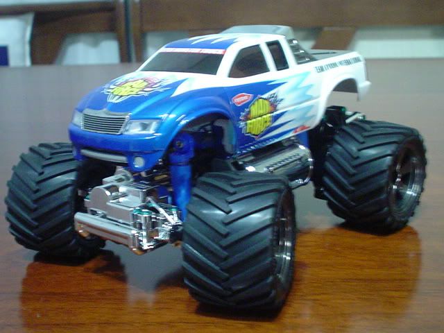

…chrome bits here and there, couple of bucks, blue screws, pinch of sh!t, inner antenna, not much, alloy rims, a few yen, bearings all round, few dollars, inner sponges, gratis, alloy damper mounts, a few bob, A PanicToys.com assembled Monster?
…PRICELESS…

What are the blue covers over the shocks and where did you get them from? Are they heat shrink tube or blue tubing that just happen to be a snug fit? Does it affect full suspension travel?
January 10, 2005 at 5:11 pm #57914
Bithed calls them “shock boots”; made by him, they come in red, blue or yellow (for the stock, low-down or oil shocks respectively), and keep the majority of gunk out of the shock shaft area… meaning smoother movement for longer periods before needing to be cleaned out.
January 10, 2005 at 5:18 pm #57915
The shock boots work well…. My advice to anyone with alloy bits is to use loctite… Monster is currently in pices while I work out what to do about all the missing screws and balls 🙁

loose the coloured screws, they’re smaller diam. than the stock… thanks for the warning in advance with the ball joints though. Mine have stayed pretty well, is it because of the alum. damper stays that the ball joints are coming out, or just general wear ‘n tear? oh, and Snailpace; no effect on the shock movement whatsoever, at least on mine… how ’bout yours Aaron?
January 10, 2005 at 5:48 pm #57917
I refitted the condoms on the shocks, so they were tight around the top of the shock and piched in place by the mounting screw… This seemed to stop them from (very very occasionally) munching up in the bottom of the spring.
With the screws in metal I don’t why they’re coming out, I think the vibration and being good quality alloy/screws theres not much friction interferance happening… Seeing as they’re upside down well….
A.
Site Owner Guy. -
January 11, 2005 at 9:01 am #57931
Good idea with the shock boots. Aaron, i’ve had the same issue with screws and ball joints coming loose off the aluminium parts on my monster. I also find a small dab of clear nail polish on the screww threads keeps them from coming out. Gives a neater finish unlike the blue/green loctite color.
January 11, 2005 at 4:04 pm #57936
ah, yes… nail polish. Thank you for that, i’ll be sorting out my threaded servo boxes now too… damn good idea:D

January 24, 2005 at 6:33 pm #58221Quote:I got one of the GPM damper stays and the screws are fine. The are on ebay here is australia for about $20.
Are the stock screw are for plastic? that might be why they have a different thread.
stock screws are for plastic, yes. You still have stock shocks, yes azza? Due to my having oil shocks, there is less screw left to grab the rear damper stay. Where they fix is a little chunkier than the stocks, so i only have 1.5mm of screw grabbing the alloy. The front alloy is fine. Going back to stock rear and screws tonight
January 24, 2005 at 9:22 pm #58231
OK dgs73, I didn’t realise.
That sucks then . I’m really happy with my mount (stock shock though). I’m not afaid to treat it bad anymore :evil::angry:
January 24, 2005 at 10:33 pm #58236
from mine and ph2t’s experience i recommend buying some thread lock for the screws that go into your alloy parts.
if the screw protrudes through the part once tightened, put a nut on the exposed thread and tighten that too:8ball: -
