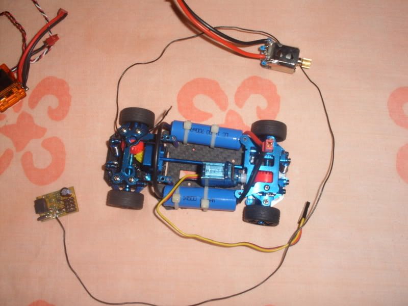

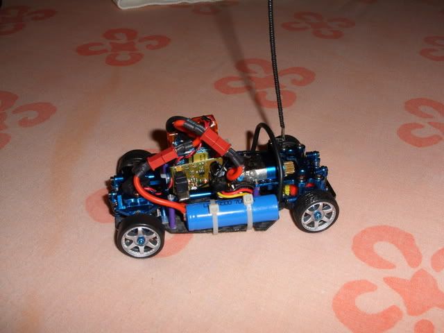

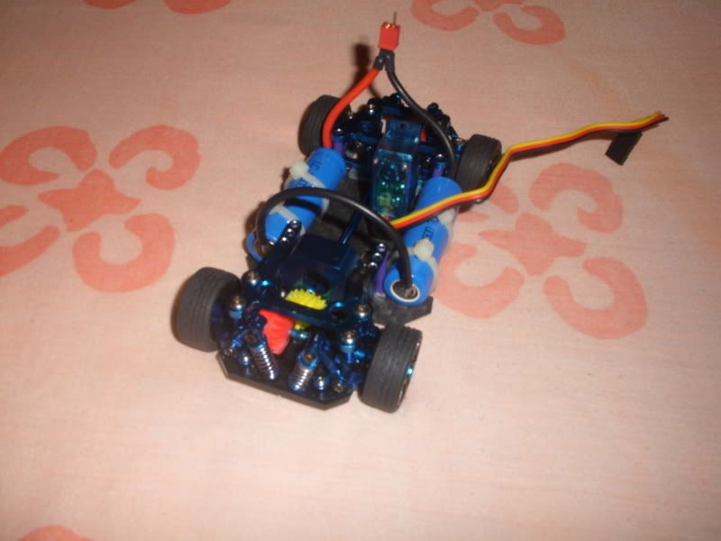

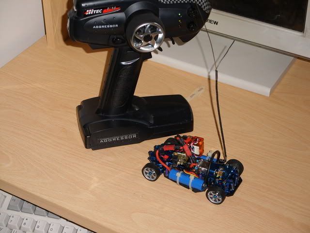

Hi guys I have been building this for some time now so I thought I may as well start a thread of it well it’s called Electro’s Xmod
What is it?
Well it will make a mini z run for it money but how can it it’s a crappy XMOD well you will see what goodies are Packed inside
What do you lot think of it so far?UPDATE
I have nearly finished my XMOD it is fully GPM and its got hobby grade electronics I have given it a short run in a very small place so but could not get it to go full speed not even 1/2 throttle had to keep it as low as possible as I got a Jet -Dash in there which is Tamiya best mini 4wd motor and has 22 torque and its got neo magnets to give it even more torque to carry all the GPM
As for it running, it gives me a good run but I’m getting some major interferes (might be my battery in the transmitter or my RX) but other then that it turns good, I might try get a video of it but I haven’t got a big amount of space
Currently I have been working on making every thing nice and tidy and cut all the spare wire as almost every one who does a hobby grade XMOD always looks like every thing is jammed in there and nothing is tidy.
Well I think I stop talking and let the pictures do the rest, sorry I have’nt got pictures of all the electronics mounted but i will when I tidy thing up and i post some more pictures
UPDATE
Ok guys got new pictures of the Final Electro’s XMOD with all the electronics and everything done to it since I have finished my XMOD I may as well add how much this little bugger would cost you bank account and to make every thing simple I will list all the modifications with there price printed on the sideGPM XMOD Gen1 Billet Aluminium Cup Joint Shaft Set – Front $14.99 =£8

Well I can’t make the price any sweeter so I will just have to give it to you in plain numbers £247 Pounds and that’s $507 US DollarsWas it worth it?
YES and Y E S this thing is worth it the car just screams down to my end of my road so quick you won’t even to able too see it once its goes out of site and mind you it does that under 5 seconds (well not 5 sec but you get the drift) from start and with range with 500 Meters you know you car is not going to go out of range and you still have so much control over it
Unlike XMOD shitty range which is actually less than 20 Meters (unmodified) until things start acting up also my XMOD has more range then you Mini z lovers out there
Well here are some of the pictures of the Final XMOD
I think I will stop there.
