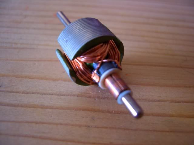

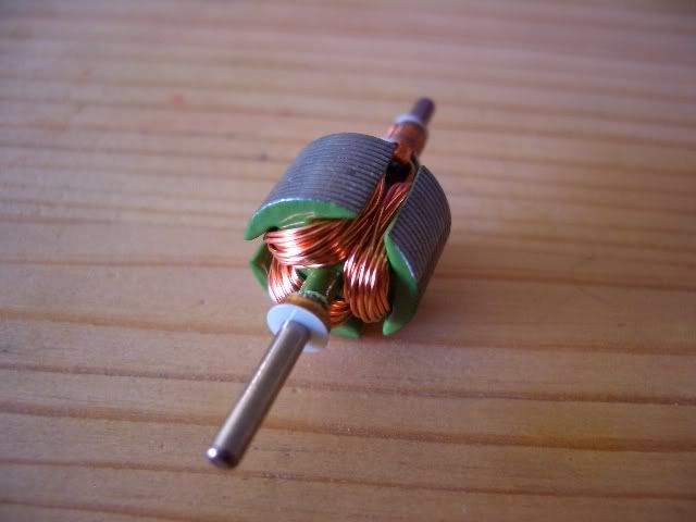

What does the armature look like, got a cam Traveler? some photos of the guts would be cool. What’s the size of the commutator? is it like all the others in the 4WD family of motors?

Couldn’t get the camera to focus in on the armature. This is the best I could do…

Not that it matters but I found these pictures in my file of RC stuff of theJetDash armature.
I liked it a lot as a basis for a really fast motor but I found it only really useful on four cell aaa…anything more is just waaayyy too much power.
I have other motors that are smoother low to mid range but for my liking the Jet shiines at full tilt.:D
