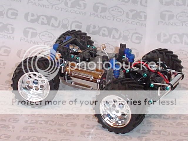

…NOW that i can finally post pics INSTEAD of links :)How about THIS ONE? Looks good eh Aaron…

There are 12 places for milled balls and I have filled in all 12 with PanicToys ‘Slippery Nipples’…They are a LITTLE bit different to the KYOSHO ones but essentially the same thing…I use them on MY monster too so they are good for sure 🙂
