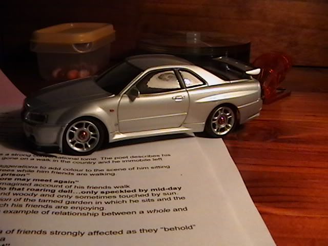

      here are sum pics..
      So SeXy:
      Under the bonnet:
      Edited by – icebreaka on 29 September 2004 21:45:40
