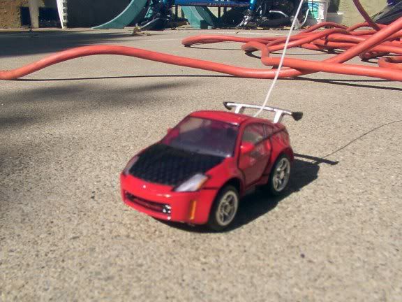

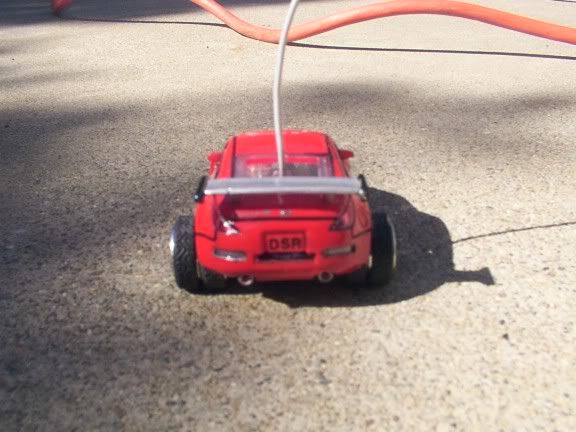

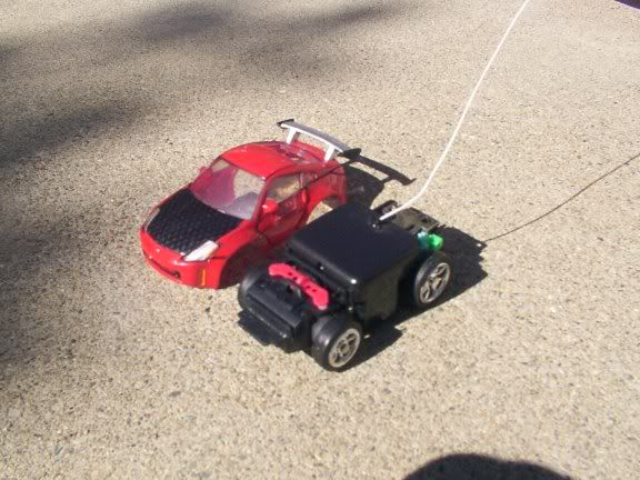

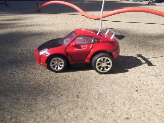

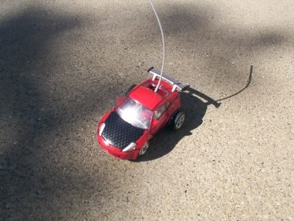

this is my lil sleeper
from tha outside it looks like normal single cell. even after the body is removedheres sum pics of it with dubble rims
October 13, 2004 at 11:57 am #56104
Looks good dude. I like the hood. I would get a thin guitar string for the antenna. That would make it more invisible. Plus the range would be better.
October 13, 2004 at 12:18 pm #56107
nice one! but it’s just too neat! can’t you hang some wire out of the cover or scratch it?:D:8ball:

haha thnx, ill take that as a compliment. i wus gonna do guitar string like my xmod but then i wouldnt be able to put in in my pocket

Pretty Spank ride Chino,i know those double wheels must give that thing some sick torque. But really you must tell me how you managed to cram those cells so neatly in a bit chassis.Because i too am working on a low profile ride that definately needs dual celling.
October 15, 2004 at 12:12 am #56146
i forgot where i got the smaller cells from but jus a lil trimming of the part the front deck screws down(only screw in the whole car) and it drops rite in. ad i have solder tabs solderd directly to the bottom charge conections
