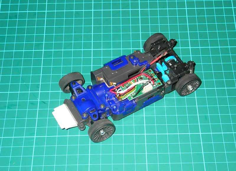

      Hey All,
      I got my ASF 2.4GHz conversion kit for the AWD the other day and it’s awesome !!
      The kit includes the new KT-18 TX, The new 2.4GHz PCB, 2 manuals (One for the TX and one for the install), a new PCB mount, a new
      top cover and also a little tool for pressing the pairing button on the PCB..

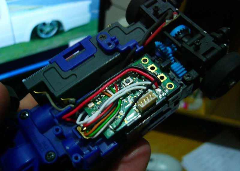

      As you can see in the pix below the new PCB is a little shorter and it of cause has an I.C.S port… One of the good things with this
      setup is no more aerial hanging out of the body (LOVE IT)!!! it also has a little LED to show you that it’s powered up and that it is paired
      correctly with the TX.. No more crystals !! (SWEET AS)
      The PCB also has a 2×2 stack as standard… :smiley16:
      It is also of cause glitch free !! I run in a colourbond garage and they always seem to have a glitch spot or two, every one I’ve run in so far has !!
      But with the 2.4 setup it was completely glitch free !! (VERY HAPPY)

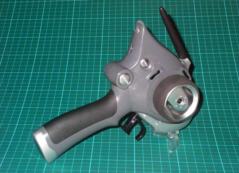

      The TX may look a little weird to sum but it is sweet to use !! very lite and it fits the hand just right !!. It’s also very easy to setup !!.
      I personally really like the look of it and having the short aerial is great, No more accidental poking.. LOL…
      It also has a quick release battery setup and uses only 4 AAA’s which is of cause part of the reason it’s so lite !!
      All in all I’m very happy with it and have ordered a 2.4 PCB for my MR01..
      If anyone whats any more info just ask and if anyone else already has a ASF 2.4 setup in an 01, 02 or AWD post up your thought’s !!

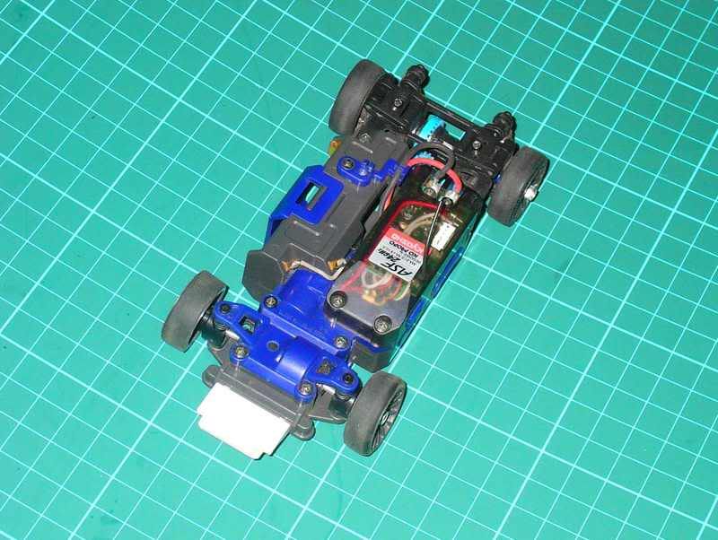

      And that is the way of stocking FET on my 2.4GHz. It was installed by Mini-Z Club Track in Hong Kong:smiley16:

      Ken, Why has that PCB only got the + side of the motor terminals stacked ?? is it only the forward FET’s that are stacked or something ??
    • #61889
      ken_wyleung
      • Posts: 236
      yes, it is only for “forward”, it is the track-keeper recommanded.
      So, I cannot run “backward” for long distance or long time with FET upgrade request motor.
      Cheers..
