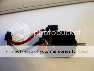

wut kind of fets are u using. i use 2×2 of SI4562DYs works way better than a 6×2 of IRF7389s.
but that whoe nelly would work better.motor im useing a modified plasma dash with
ballbarings , cus tha stock bushings SUCK
neodyniums
large comm
37 turn armature
http://img17.photobucket.com/albums/v51/chino925/motors/PD_plasma_dash.jpgu guys should really try mixing pinions and bevels. wht bevel with a 10-11 tooth pinion works great. use cut off from tha end of a pen’s ink tube for spacers to raise the motor mount. place under mount around screw.
also u should try a drive train breakin.
mount a crap motor
hook up direct power from a type of power supply
make sure the motor is not hooked up to tha car
while it runing lube it (i like to use silicon lubricant spray)
let it run over nightafter it should roll like silk w/o a motor installed. this makes it easier for tha motor to push the car.

had to go back up to a 37t before i got my fet upgrade. right after i did a 2×2 stack it ran much better. i really liked the way it proformed (spinning all 4 tires w/o spinning out is kool) so didnt wannah change it jus yet. long gears of an xmod well suits it(torque). i will eventually bring it(the turns) back down cus my SI4562DYs dont event get hot.
one of tha fastest motors ive made is a cutom
pyrimid wound
19turn 180
180 can
180 armature
130 end bell
130 brushes
130 comm
neos/bb (opional). its tha motor i make for racers out here usein mrs4s xmods and minizs but for z users i have to make the motor a tad shorter since they kant used full size cus if the sideways mounting. Zs dont do well with too much torque anyway so it all works out. the armature legs are more than twice the size of a normal 130 arm.
pics here, i kall hulk. reasons cuz 1. i jus watched the movie 2, it size 3. most of tha parts jus happened to be green
page 2 also has more pics of it
