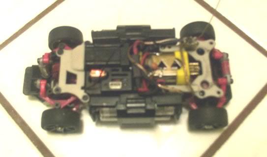

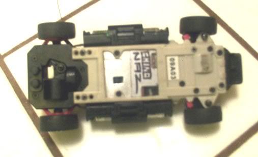

      what’s that baby’s specs? looks like it has a lot of take off power…:smiley16:

      4 cell
      single stack si4562’s
      s2motor-bb can, neos, 40t
      plastic shaft
      ball barrings
      resistor mod
      lightened chassie, battery holders and decks
      awd
      alloy rear cups
      putty locked rear diff
      grease filled front diff
      alloy lugs
      upgrade struts
      stock spings in front
      soft mono rear
      speaker wire
      hard slicks
      11t pinion
      red bevel
      funny cus it sounds like alot but its not much. its acually mellowed down from my setup before wich had 2×2 stack, custom plasma dash(rewound arm’30t, neos and BB). this new set up has way more torque and the battery life i wus looking for, i only lost about 4kph off the checker 34 down to 30…i guess its alot haha. plus i needed fets for another car.
      im glad u like it, its a cool comming from u. i promise better vids soon
