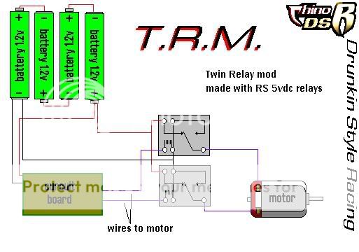

graphite flex platehits 24 kph (speed checker) picks up really quick. seems easier for tha z rear end to push tha car. i need to find a way to make a powerful rwd car w/o breaking dogbone cups. i guess i found my answer. later today im planin to put realays in since ive ran out of fets. 20 turn double wound motor. and an 11 tooth pinion.
http://img17.photobucket.com/albums/v51/chino925/diograms/TRM_diogram.jpg theres more than enough room for relays in the middle since motor isnt there anymore

relays
and a motor -
June 24, 2004 at 10:48 pm #52797
(update)
relays
tamiya sprint dash
11 tooth
47kph -
