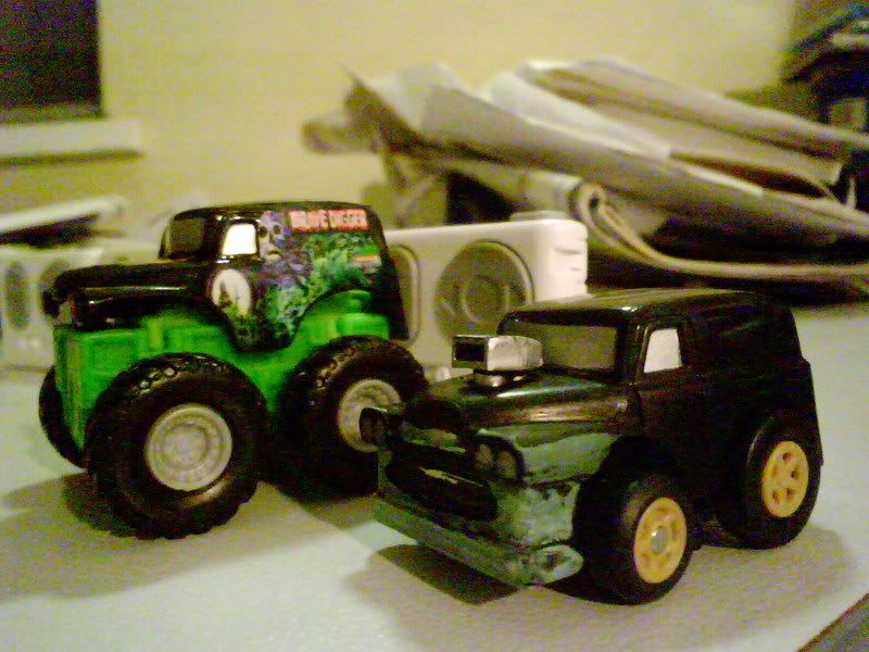

hey guys, got some pics using the not so good but very handy psp camera attachment.

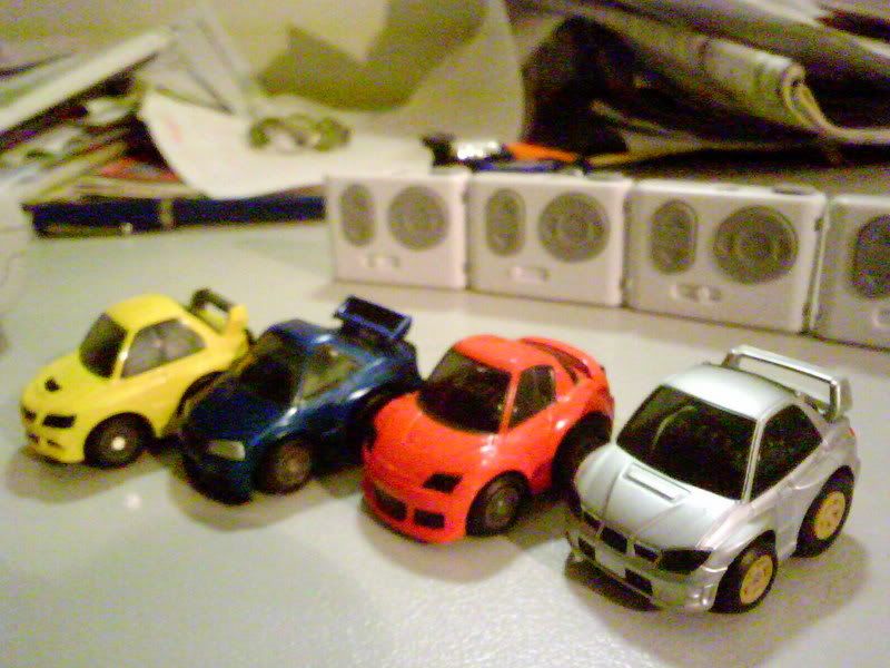

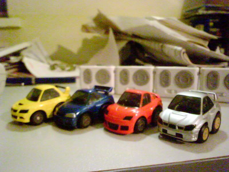

the 4 basic cars available here at the moment.
gravedigger monster truck donor body in its original state next to the in progress ford hot rod. hit a problem in that the windows and the body are all black plastic and wont let the IR signal through. options are at this stage to cut out the windows and do them in clear plastic and give it a sunroof or finish it and have a go making a mould and casting it in clear resin.

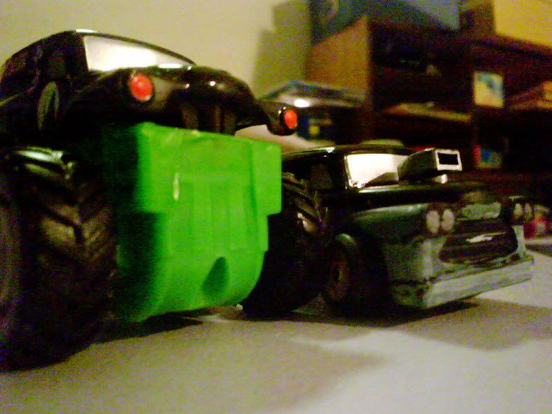

detail of the front end so you can see how much scratch builing is needed.

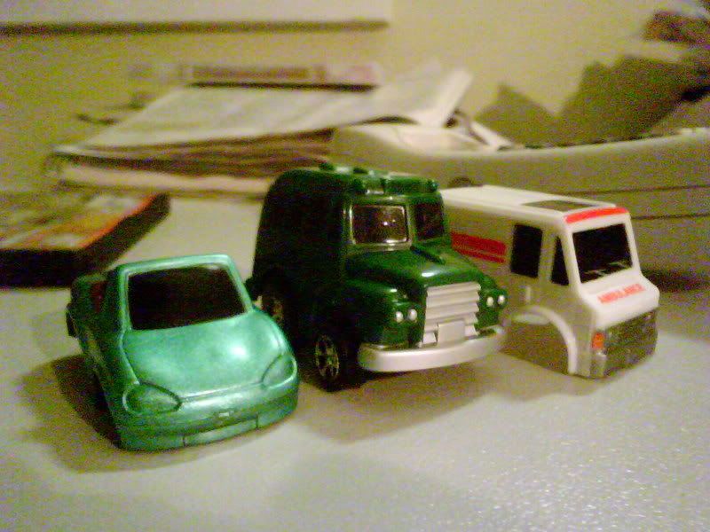

some spare bodies found from “kids r cool” 2 pack of racers from coles (mx-5), a toy story 3 pack of pull backs (bus) and a single pack “zipper” pullback from the trackstars line in a safeway store.
the kids r cool stuff is so bad quality, but a nice place to start with modding. the toy story stuff is overpriced and the 3 packs arnt random so you allways get some junk body thats a repainted x-trek shell (the lame sci-fi looking ones). the zipper had decent paintwork and the detail is as good as q-steers only the windows are painted onto solid colour plastic. still bargains for under $3 a peice. -
